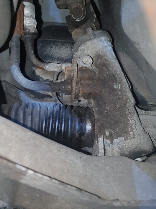

Today I 'inspected' the steering rack. I was mainly searching for the part number to ensure I order the right boots. Didn't succeed in that, got the 996 and a bit, but not the last numbers that actually matter.
Anyway, I noticed the driver side being dirty;
Having read that the main failure of the racks can be found by a boot full of power steering fluid, this did scare me a bit. I popped the boot off but found nothing but a greasy rack
I was now able to rock the tie-rods in different directions on both side. Passenger side, no play found, no noises, all good. On the drivers side I could get the clunk by rocking the tie-rod up and done (fore-aft was silent). It didn't sound like it was coming from the tie-rod itself. With the boot shifted aside I could see the rack (to toothed part) move along with the clunk.
So I guess I am looking at getting a replacement rack....
Attachment 23808
Mark, if you didn't find any oil inside the rubber boots, then the leak is from the viton o-rings that connect the metal pipes to the rack, these are not expensive and very easy to replace.

Thanks Gilles. I'll make sure I have new one in there when I swap the rack for a rebuilt one.
The brake swap story starts to turn out into a bigger project (I wonder how many times that happens..  ). So the brake line left to right didn't want to let go of the hose. Even with the flare wrenches the nut got rounded, so even if I would get it off, it won't be re-useable. Checked how to get the line out, but really see no other option than dropping the subframe.
So whilst I drop het subframe, it makes sense to do the steering rack at the same time. That means moving to the electric pump also. That needs to function, so the electrics also need to be done. It looks like the clips for the coolant hoses / pipes are accessible with the subframe in place, but there is so much space once it is out.... makes sense to use this time to drop in the S coolant pipes with the appropriate hoses. And with the ARB out, this needs either an upgrade or new bushings.
My point is that you may Not have to swap the steering rack and only have to replace the o-rings to stop the leak, awesome project, none the less :-)
Ah yes, but I'll replace it because of the play I found, not because of the minor leak. I am quite positive this is giving me the strange feel when turning. Even my wife notices it, so it is an obvious behavior.

2. Mount it at the front, behind the bumper cover
+ seems like plenty space there
+ easy hose routing to the rack
- longer electrical wiring, but still ok I guess
- not accessible to fill it up (although I can't recall the last time I had to top up power steering fluid..)
- no more option to add third radiator
On the aesthetics of option 1 I was thinking of getting myself a brake reservoir cover from a RHD vehicle. That might work out nicely.
