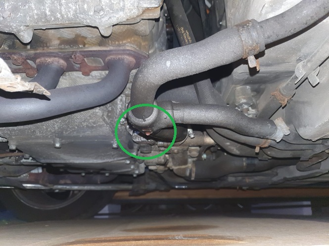

Today was fitting day. First step was to look at potential places on the engine to attach the front engine mount (Boxster style, making more sense than Audi style in this configuration).
The green circles indicate where the Audi front 'snubber mount' attaches. So good few points to hook on to. All on the right side of the engine though, so a few left ones needed as well. The red encircled hole are pretty deep, so these should work. So far, no blocking points on this.

I mentioned before that it looked like there was something dripping on the car, leaving marks on the driveway. Put some cardboard underneath to have a clean surface to look at. Obviously a coolant leak:
I will need to stick my head in there a bit further to see where it actually comes from. You can see a drop in the picture, but it could come from some higher point.
