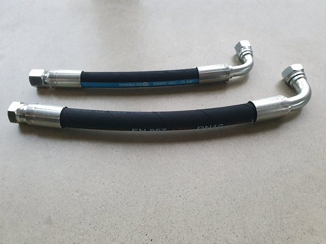

Today I went to the hydraulics shop and got the hoses crimped. Looking good;
Attachment 23871

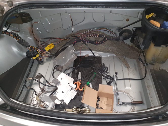

Also started stripping some wires I need from the wreck. Turns out that they potted the bulkhead feedthroughs to the interior. Messy and tedious job to remove all that. :eek:
