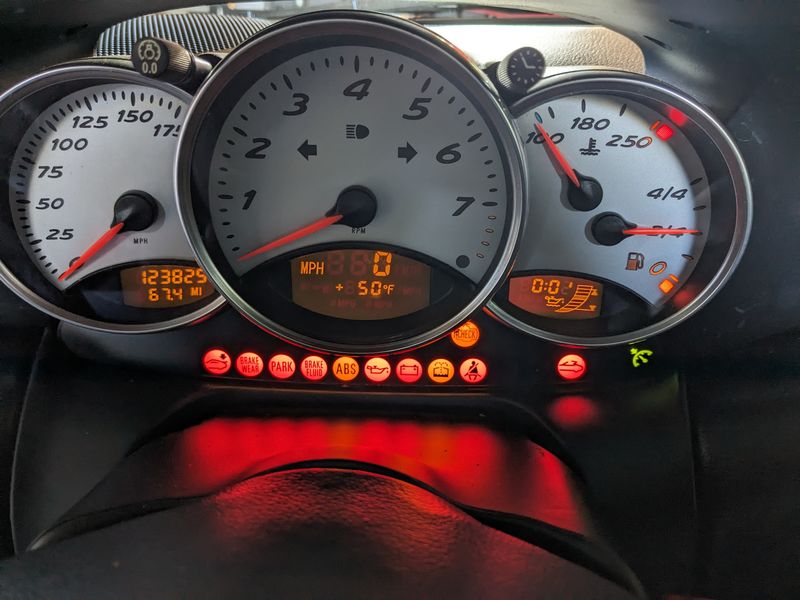

Luckyman01 11-13-2023 11:03 AM
With Key on, prior to start, most left ICON
The icon is a car profile with arrow to spoiler. on the far left of the lights. This is on 2000 S, here in USA.

Luckyman01 11-15-2023 08:13 AM
This photo is key on; car not started
When I start the car, only the far left "spoiler" light stays on. It goes out once the car is going forward at least 4 mph.
