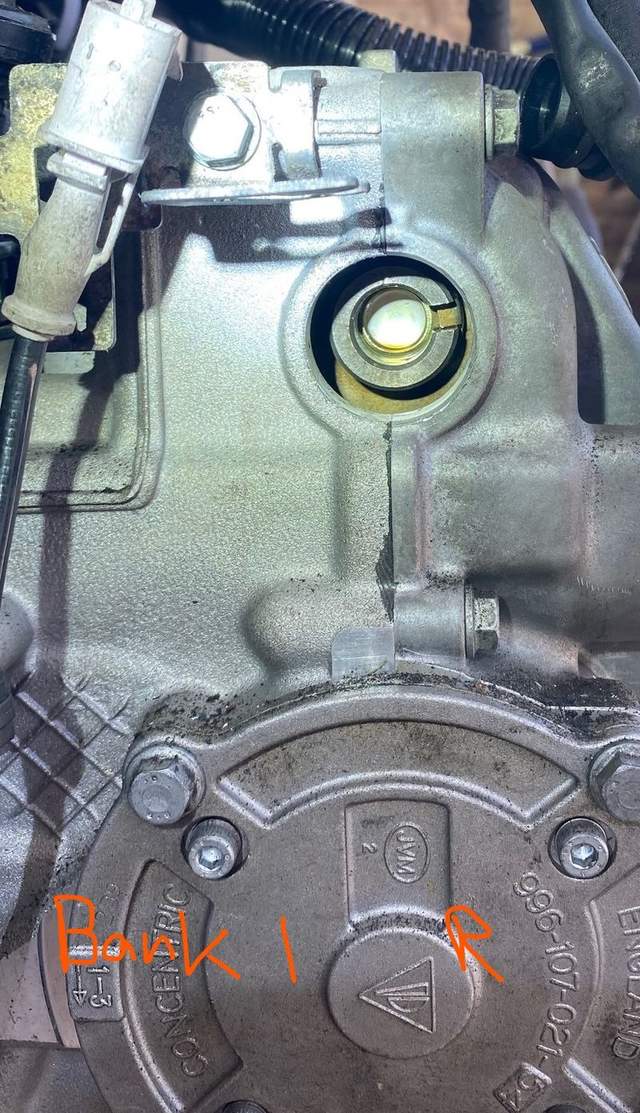

my 1999 Boxster 2.5 L only fires on Bank 1 after engine overhaul. Electrical connections on Bank 2 seem all good, and the injectors work too (found unburnt fuel in the exhaust manifold).
I had installed the camshafts exactly as per workshop manual and turned the engine many times to ensure that the markings stay aligned. But now I observe at least once cycle where all inlet valves are closed, which clearly should not be. Re-reading the workshop manual 15-20 I am now unclear if a full rotation is needed between adjusting each Bank, or not.

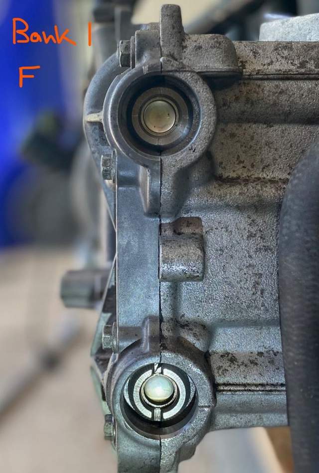

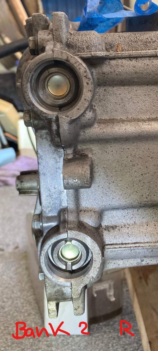

Grateful for any advice. See pictures below, showing the camshaft markings in TDC front (F) and rear (R). Thanks!

Did you take all these pictures while the crankshaft being at TDC? If so, you didn`t do the 360 degree crankshaft turn between setting the timing at the two banks. When the camshafts are lined up at TDC at one side, they need to be 180 degrees off at the other bank.

It`s pretty straightforward if you think it over. In the boxer engine the opposing cylinders must be in the opposite stroke, i.e. if cylinder 1 is at intake, cylinder 4 must be at combustion - at cylinder 1 intake valves open while at cylinder 4 all valves are closed. This can easily be checked if you look into the ports, or just inspect the camshafts' position before you put the cover back on. To achieve this, the camshafts at the opposite banks must be off by 180 degrees, hence you turn the crank a complete revolution. It does not matter which bank you time first, the combustion will be determined by the camshaft position sensor.

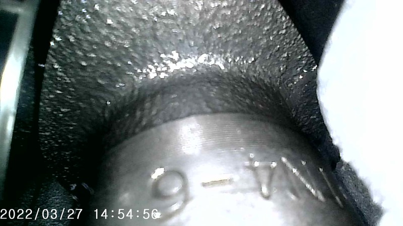

Thanks for remining me of the engraving! I was able to confirm that it is the correct camshaft by going through the middle spark plug hole with a bore cam.
I had several camshaft assemblies and wasn't sure which one I ended up using (because the whole overhaul project was interrupted for 1 year due to corona).
