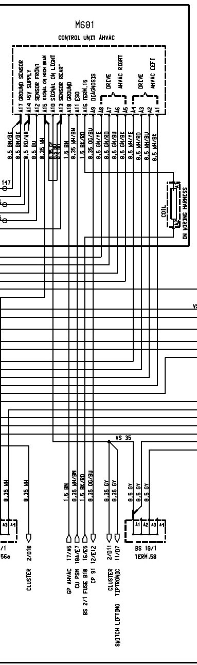

1. Connect pin #A9 (Diagnostic) on the litronic control unit to connection point (CP) 91. I believe that CP 91 corresponds to pin #3 on the OBD diagnostic port. See this wiring diagram:
This may allow me to use my Durametric to scan the litronic system to determine whether there are faulty components.

My questions are:
1. Does there seem to be a risk of damaging the car from connecting the diagnostic pin on the litronic control unit to pin #3 on the OBD port.
2. Are there any other connections needed? e.g. Do I need to connect the litronic control unit to the ECU? If so, how?
3. Does my idea make sense or am I wasting my time?
