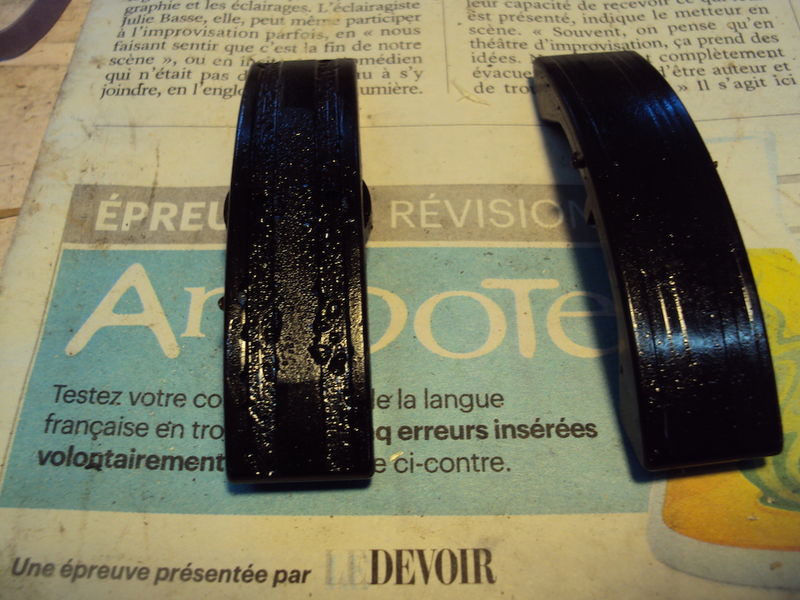

What colour is the plastic? I just changed my tensioner pads and the old ones looked like this at about 90K miles:
You can see the plastic comes of in little chips so that could explain your "flecks". My deviations were a bit higher than yours.
From what I have read on oil filter analysis you should expect to have some metal, engines shed metal as someone said somewhere. I just installed a magnetic drain plug and have not looked at it since so don't know if it can be expected to have the ferrous particles that you describe. Has it changed since the previous oil change?

The plastic is definitely brown.
So from what I've been able to read that indicates the guides rather than the pads.
