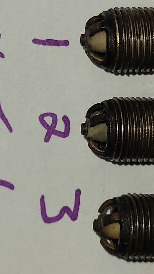

Old 07-25-2021, 02:52 PM   #60
Join Date: May 2017
Posts: 1,180
Just had a better look at the plugs. Makes no sense. 1-3 look good/normal to me. #4 though looks almost new.
Yes....made sure I am working on the correct sides.
1-3 being passenger, 4-6 being driver.
