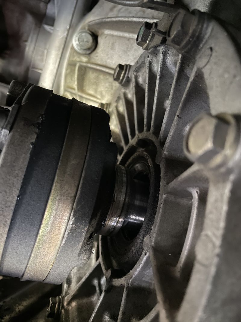

Thank You, the fluid is brand new trans fluid that was changed a few weeks before. Here's where I think it leaked out from. Whatever hold this inside the transmission came off/broke. BUT, looking close at the photo it doesn't look wet on the bottom of the hole, so not totally sure.
If finally let me upload a photo

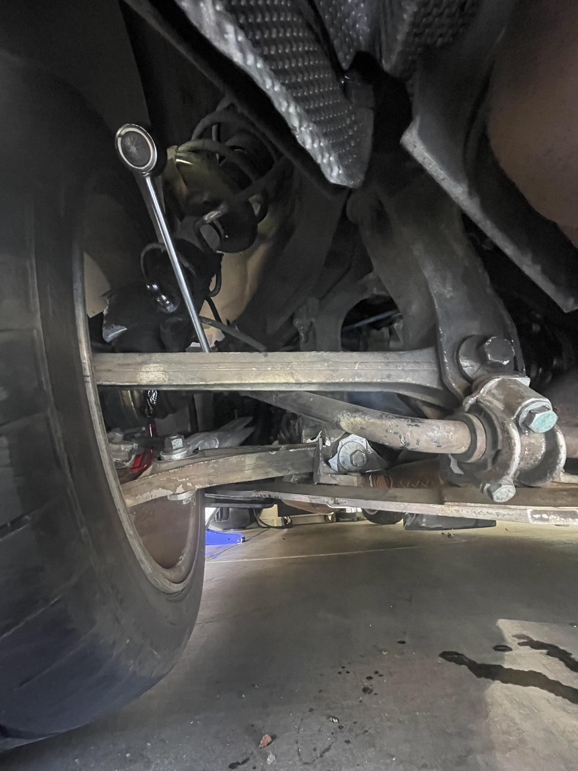

yup, that will be totaled. The biggest issue I see from those pictures is the control arm mount. Going to have frame damage looks like. hate to say it, but I'm going to say it will be totaled.

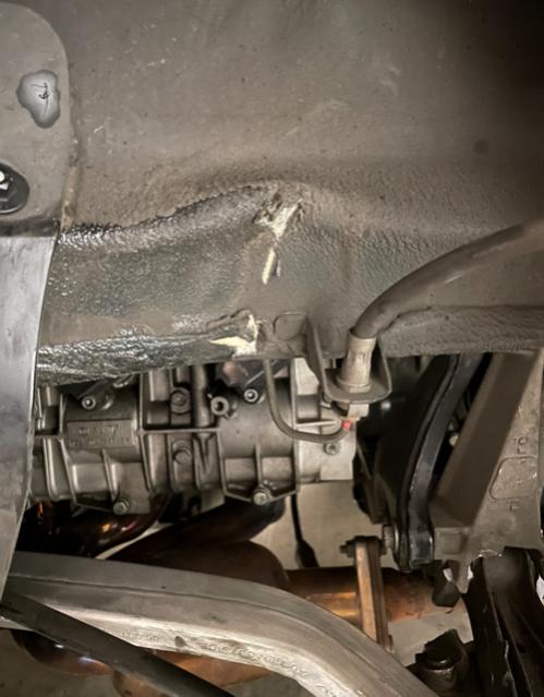

Here's where I think the hub carrier or something hit the frame, it's got a little dent but could that bend the frame.

Jasper, it seems that the transmission oil that you saw it came when the shaft was pulled from the gearbox, actually does not look bad at all! You want to clean it properly, install an new oil seal and push back the axle into the gearbox when replacing the damaged suspension parts.
Again after you receive the the insurance decision, you will want to remove the broken (and bent) suspensions pieces, would not be surprised if you can get it on the road for not too much money.
Can you still decline the insurance (repair/write off) and fix it by yourself? This way the car will have a clean title..

From the drawing it looks like there's a C-clip that hold the flanged shaft (item 15) into either item 5 (differential pinions) or item 1 ( differential housing) so to me it looks like the only way the flanged shaft came out is if something broke off when it was pulled out.

I have it on a flor jack now, a jack wouldn't fit under the rear so I used the cars jack to lift the front enough so the floor jack would fit under the rear.

[QUOTE=Jasper7821;636029]From the drawing it looks like there's a C-clip that hold the flanged shaft (item 15) into either item 5 (differential pinions) or item 1 ( differential housing) so to me it looks like the only way the flanged shaft came out is if something broke off when it was pulled out.
The circlip will snap off when you remove the shaft, simply reposition the clip and push the shaft back into the gearbox.. (yes, that simple..) Just clean the shaft properly and install a new oil seal..
Once you get the pictures for the broken/bent parts we can help you with a more educated guideline, take one step at the time, (so far) I don't see it as a deal breaker..
