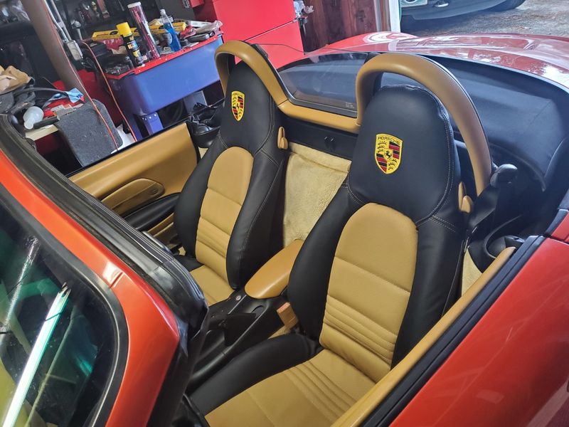

I did mine a couple months ago with zero experience. I watched these videos for how they are disassembled which then it was obvious how they go back together.
https://youtu.be/ynGjh2jOU0A
https://youtu.be/_kJgwUh5PpE
I think mine turned out pretty good and have been told the sun will shrink them some and tighten up the few waves they have. I've alreadh seen some improvement since this pic.

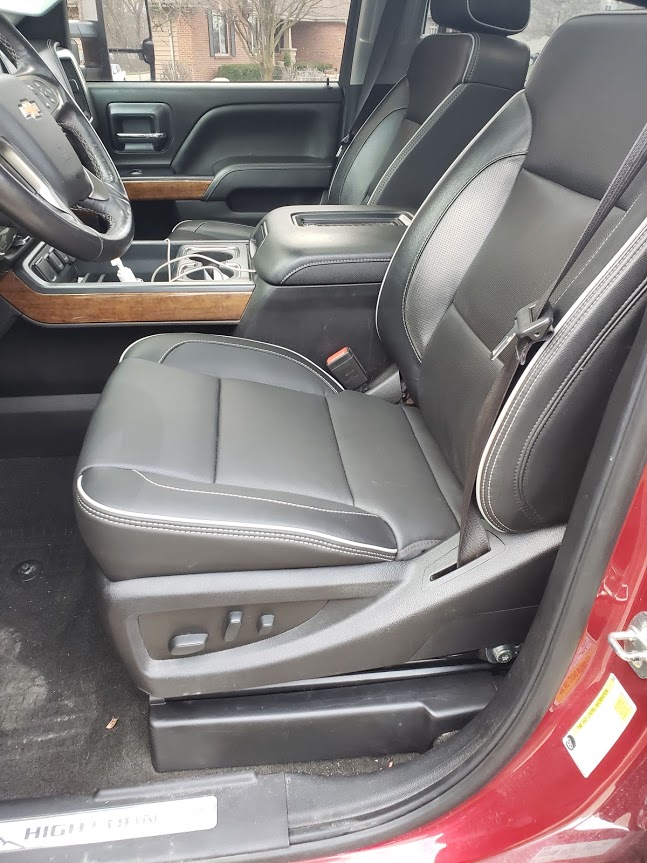

I sent a private message but just for example this is a Silverado seat I did after work tonight for one of my wife's co-workers. I am not an upholster but if you watch what your doing and take your time its not that hard. The seat base on this seat was replaced after removing the seat, removing the cover, installing the new one and reinstalling the seat. Total time about 2 hours.
