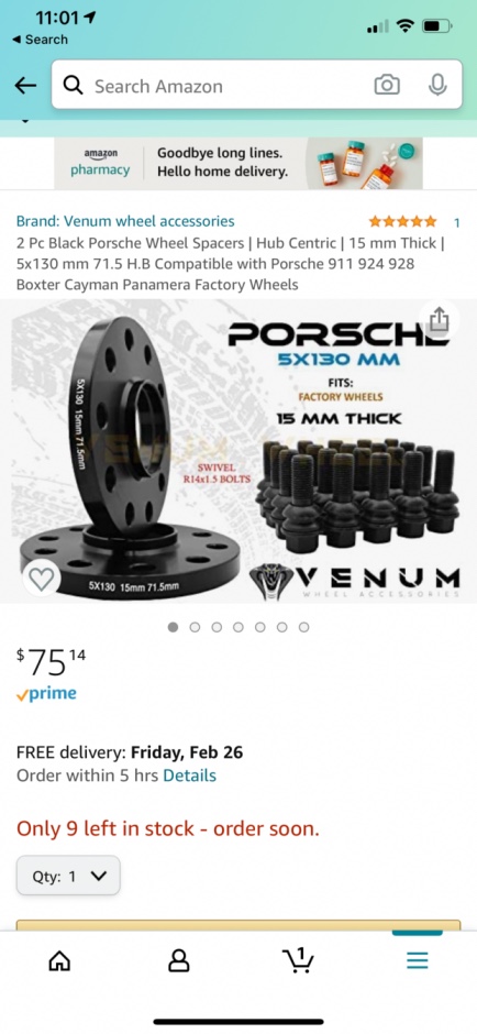

This look like them?Name:  23D2CAB6-65A1-4C33-972D-F452F253C615.jpeg

Originally Posted by Escott1622 View Post
This look like them?Attachment 22837
That's them. Here's the set I have.

Make sure you get the kit with the two-piece bolts w/ the swivel collar that Ike mentioned and not the one piece bolts. They'll send you the right length bolts when you order the entire kit.
So this?. I normally never mess with spacers so I tend to not know what I’m taking about

That's the one. You'll need to order two of those kits. One for the front, one for the rear.
