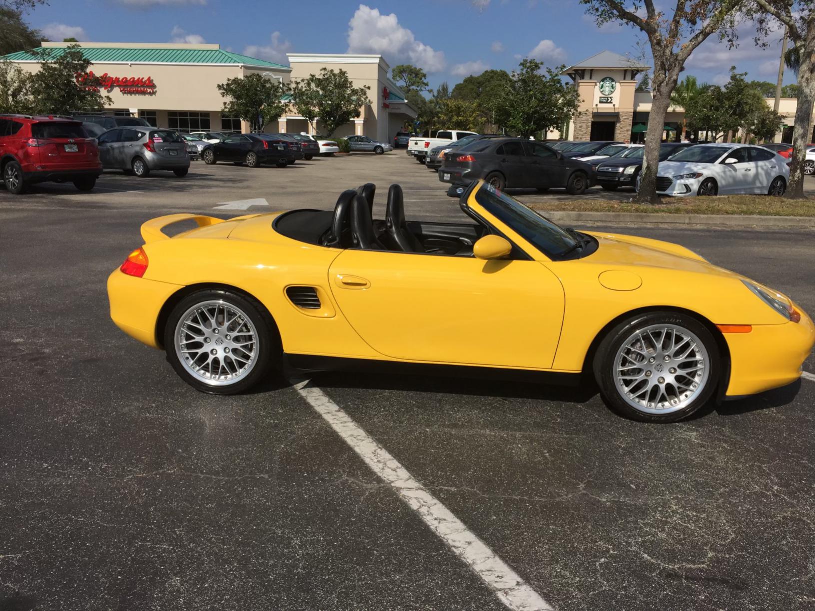

The cars from Florida and is kept covered

Dang! She's a looker! Hop on the Porsche train already!
