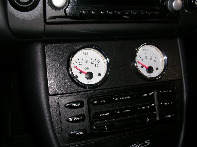

If your real goal here is simply to add this pair of gauges, the path of least resistance is to mount them in the console:

Hi
Yes, I did think about this, but I have the console delete, so for me its not an option.
I was considering a pod, but the neatest solution is Porsches one........

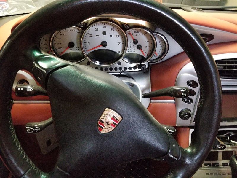

I doubt you can cut the oil and volt gauges off of a 996 cluster and graft them to your 986 cluster as there is likely one continuous circuit board across the back of all of the gauges. You can swap the entire cluster with a 996 cluster from the right year and the same type of transmission, but you need to have a specialist reset the mileage if that is important to you or legally required. Pelican Parts has a how to project article on the gauge swap.

You can install the 996 cluster. There are instructions in many Forums. There is even instructions how to code them.

I am just about finished with this project. The 996 cluster is in and everything works, just waiting on the crimp pin I need to hook the new oil pressure sender to the cluster.
As to the original question I would say that the new added guage servos are connected to the main guage board with ribbon cables. This leads me to say that there are several electronic bits and pieces on the main cluster board that are not on a 986 luster board. I could be wrong but I do not think it possible to cobble the 996 voltmeter and oil pressure guage to a 986 cluster.
