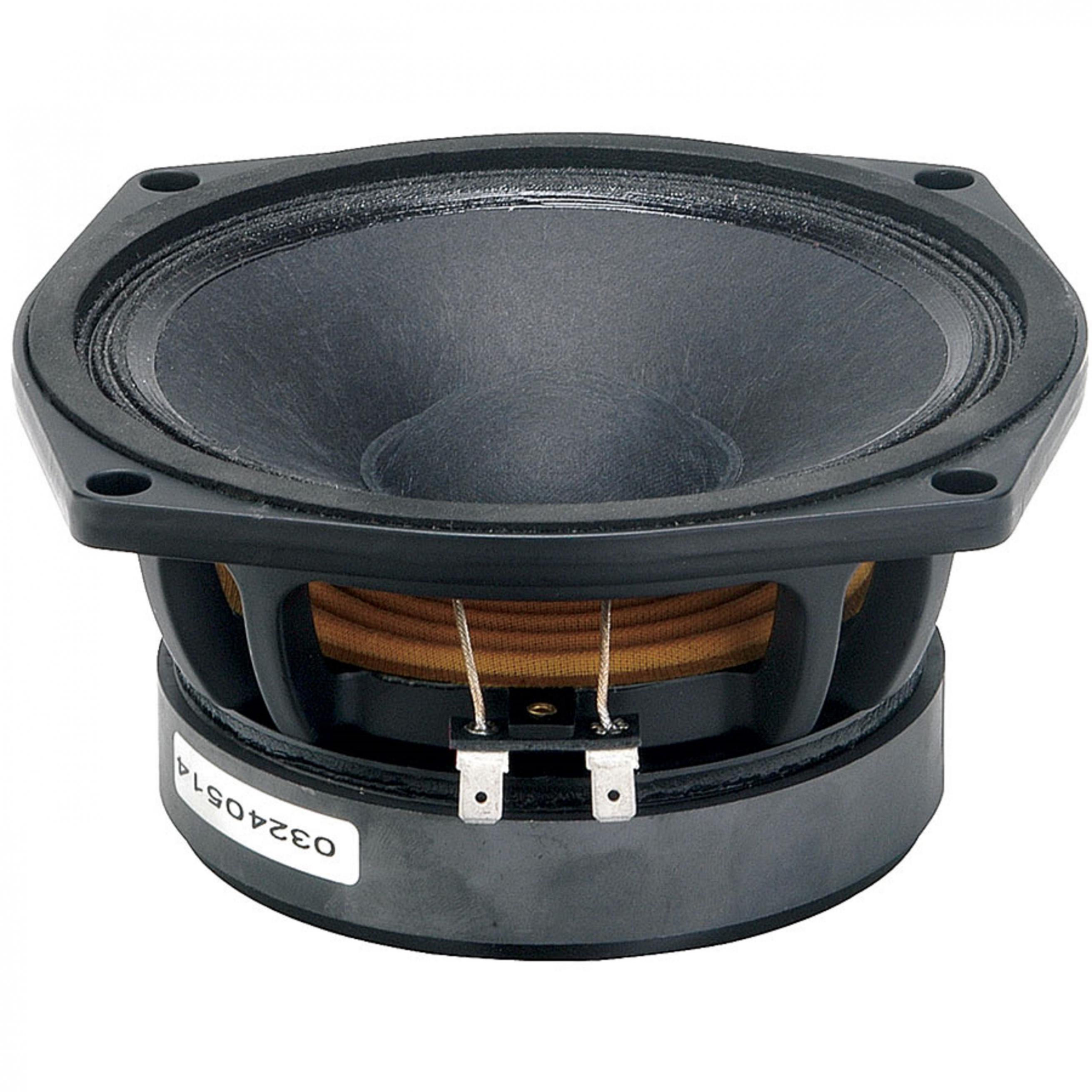

Starter986 06-24-2020 07:39 AM
This might sound good in there.
Attachment 22406
