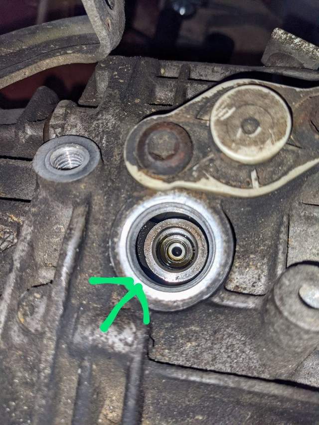

I picked up a Boxster late this winter and have been going through my 101 projects book with new clutch, flywheel, IMS, and RMS. Finally getting the car in the back together direction. I pulled the fill plug on the transmission since I felt it would be super nice and easy to handle while it's sitting on my bench.
After I removed the plug, looked at it and decided to call it a night, the plug is disagreeing with being threaded back in, and it's acting like it wants to get crossed up right away. I'm not sure if a piece of metal got stuck in the threads and jammed it up or if it just got a little goofy on me.
Has anyone run into this sort of issue, or does anyone happen to know the thread specs on the plug that I can make sure they are ok before I keep going?

Thanks, It seems to be lined up square, and tough to get crooked since it has the magnet on it as well. I just get it in a couple turns and it parks very firmly. Looking at the threads it doesn't seem like its really off, and they look pretty clean. I'll see about cleaning it all pretty thoroughly and give it another go.

Guess it was just an issue of me learning about the car... the area the magnet slides into is connected to the linkages on the back of the transmission. without it being upright or those connected, the tube was no longer aligned with the fill hole so the plug was stopping when it hit it. Fiddling with the plug some as I tightened it solved the problem.

You may be getting ready to learn more about your car than previously thought. The plug you pulled was not the fill plug on a 5 speed. That shaft has a spacer which has most likely fell to the bottom of the transmission. Attached is a discussion with pictures of the location of the drain and fill plugs (post 19) along with an exploded diagram showing the shaft and spacer (post #13. parts 16,17 18 & 19). Disregard the 6 speed discussion.

Oof, yeah. I was moving it around a decent amount as well. this will be fun.
It appears as though I removed part 16, with the rubber gasket on it, which is still attached to the removed part. looking at the correct plug next to the driveshaft it's rather embarrassing how I came to that assumption. Thank you for steering me right

You're welcome. It is disappointing, but best to take care of now before major internal damage can be done. And it's already out and on the bench!
