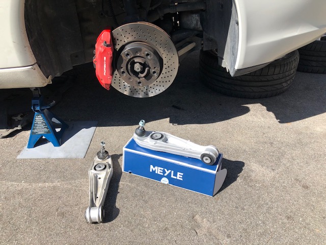

Having recently bought a higher mileage 2001 Boxster S I've been replacing suspension bits. New control arm links eliminated the low speed knocking both front and back. A local supplier talked me into buying OCAP front control (coffin) arms. I installed them and the ride was harsh with lots of kickback through the steering. Handling just didn't feel right. Not the refined fluidity expected of the Boxster. Ordered Meyle lower control arms from Pelican, just installed them and me and my car are breathing a sigh of relief. Everything feels great. So, I'm putting this out there for all who wonder if there is a difference. OH YES! Expensive lesson. The castings look identical, but obviously Meyle has tuned the bushings properly, whereas OCAP has not. In the picture, the OCAP arm is on the left.

Thanks for this. I am about to deal with this one soon, so this is great to know. It seems like (in general) the difference between Porsche Branded parts and the German or “Tier 2” level of parts is not all that great. But the difference between “Tier 2 (Meyle, etc) and “Tier 1” (OCAP, URO, etc. can vary wildly. This is just my opinion. Any thoughts?

Glad to share this info. I was actually looking for some definitive info on this (OCAP vs Meyle) online but couldn't find any actually A to B comparison on the same vehicle. So here is my experience, and in the case of 986 coffin arms, the Meyle are good, OCAP are garbage
