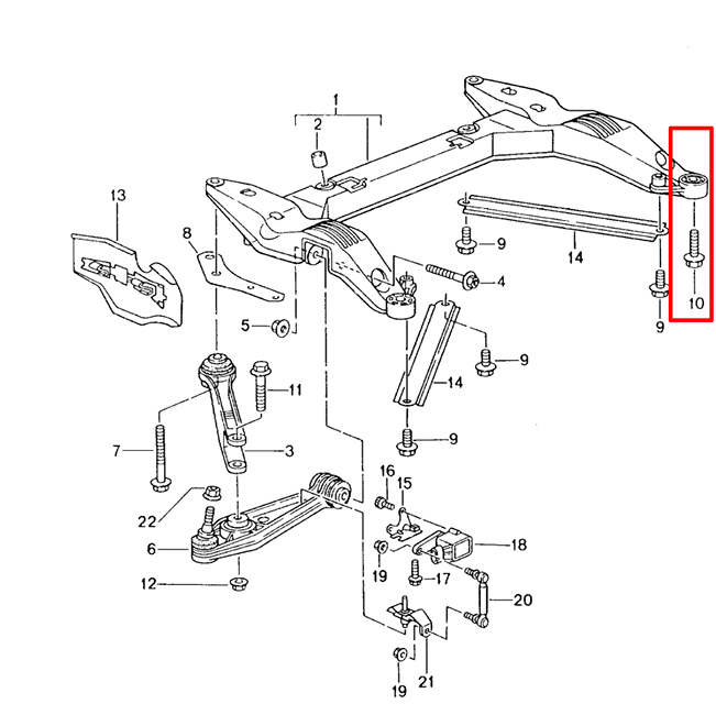

So I got the car in the air and re-checked the torque on all the bolts on the front cross member. They were all tight, except the two that bolt the rear of the cross member to the body - those could take some more torque (up to spec).
Symptom gone

Thanks never would guessed at that being an issue. Do you think you need to re align or confirm set up?

It shouldn't need to re-aligned. All the other bolts were tight, so the crossmember wasn't moving laterally.

Took it to alignment because I replaced the Tie Rods. Those I did not do during the suspension rebuild, so hoped these would eliminate it, but it did not.
