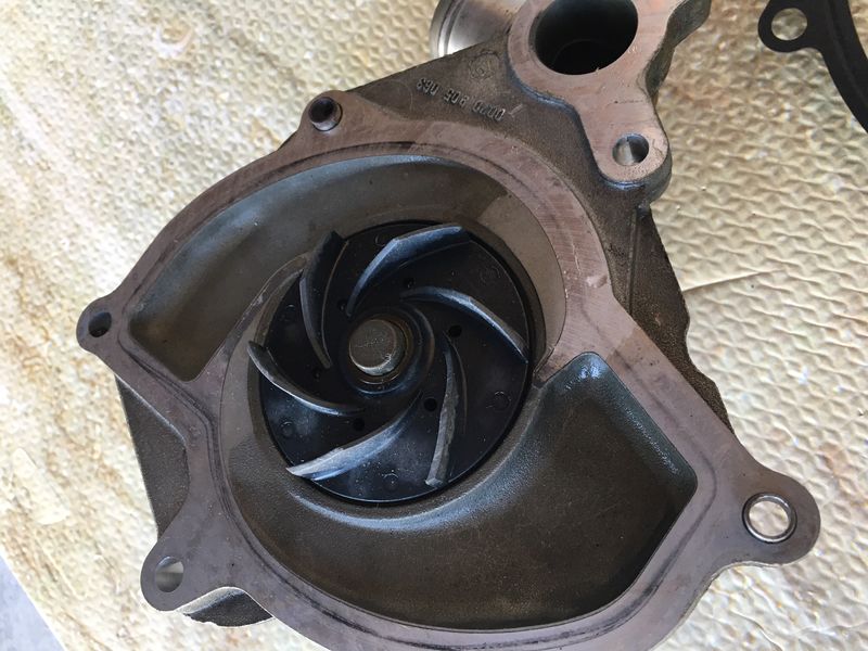

The water pump looked like this when I replaced it:
Yikes!! I can't imagine what the rest of the innards looked like. This is my 20 year old pump.
The tolerance between the impeller blades and block is very tight on these engines. Just a little bearing play and they begin to contact and wear against the block. That's why the professionals keep saying not to use pumps with metal impellers, they will grind away the block instead of the blades.
Looks like yours was starting to have contact. Good call on replacing it. (Picture rotated and enlarged.)
You might be right. There doesn't seem to be any play in the bearing - but I have noticed that the engine seems to be a bit quieter, there may have been a bit of scraping going on. She is now put to bed for the winter - tucked away in my hangar.
