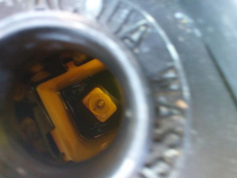

After a 45 mile run in the mountains, I noticed the low coolant warning. I check the tank and it was below the sensor.

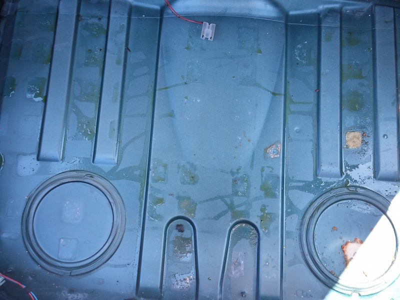

Pulled the carpet and insulation. Coolant in truck.
Someone's been in there before...note loose bolt. Not too much coolant...
Cleaned everything off and filled reservoir to MIN with ~2/3 gal of distilled water.
Felt around backside seam and it's seeping. This morning I see a small puddle, no fluid from underneath, but seems originating from around the bolt and a thin line below the sensor. Never had a puddle under the car, so where'd so much coolant go?

Just based on the color of your tank ( discolored ) it is showing classic signs of leaking . The plastic tends to get brittle with age and heat cycles and then either a crack forms or a seam starts to leak . Nature of the beast , would be cool if someone made a direct fit out of aluminum . It is a pain in the neck job but with the proper tools and a lift about a 3-4 hour job .

My "indy" just replaced my 1998 Boxster's tank 2 weeks ago and he charged me $1,200 (OEM Porsche tank). I'm not a DYI guy so I paid the price. The old tank was yellowed and developed spider cracks on the bottom. The spider cracks would expand once the tank became pressurized and would "weep" coolant which eventually would find there way through the trunk and onto the garage floor. Unfortunately, the tank replacement came on the heels of a water pump replacement ($1,200 OEM Porsche water pump). It was an expensive month but I have to admit that in my 15 years of owning, it's never cost me anything other than the typical tires, brakes and oil changes....so I'm fine.
