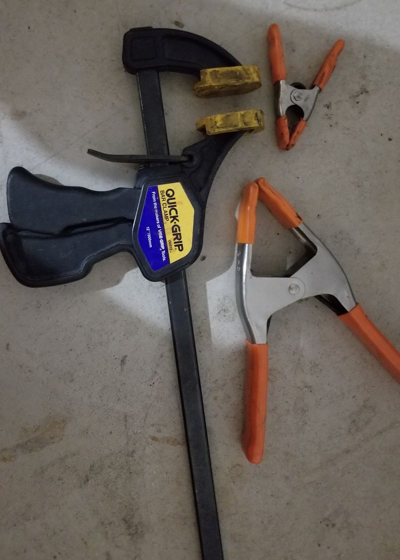

Now that said, I had the luxury over the past few days to experience maintaining my 99 Boxster. I replaced the failed water pump, bought the 163°F thermostat w/ housing (avoided having to buy the "Porsche" thermostat removal tool), serpentine belt, air filter, spark plugs, and the left front cooling fan.
Conclusion: If the pulley on the water pump was approx. 3/8" smaller diameter you would actually be able to put a socket on all the bolts instead of dealing with an open end wrench. I found it is much easier to use the wrench in the picture vs. the wet noodle flexible socket adapter for the lower right front bolt.
I used the clamps in the picture for the coolant hoses instead of the one recommended in the manual. I already had them in my tool collection.
