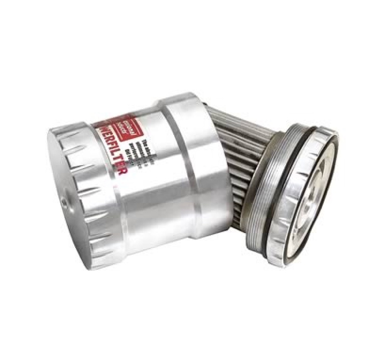

Old 07-26-2019, 09:39 AM   #6
Originally Posted by jsceash View Post
I have one, they are expensive, but with track use 30% of my driving it makes it very easy to pull the filter seperate it and look at the screens. It also has a higher flow rate than paper. 5 track weekends a year. Oil change after each one and winter storage. filter start to eek into your budget. Haven't bought a filter in 3 years.
In London not sure whats available but Ebay has them for about $130 to $150 US.
What? This is about the LNE spin on adapter, not reusable filter.
BTW, I have both, too. It is nice to be able to just unscrew the filter and have a look.

I’m not familiar with a reusable filter. How does that work? I have the spin on adapter.
Old 07-26-2019, 04:12 PM   #8
This is the one I have: http://professional-products.com/professional-products-powerfilter-oil-filters-10867
I have the 45 and 25 micron stainless steel mesh filters, but only run the 45. The 25 would require more cleaning and the general consensus is that 45 is good for street use. It also has a built in neodymium magnet.

Looks pretty interesting but wow, is this english?: «The Powerflow Oil Filter lineup consists of four basic filter canister sizes with different threaded nushings to make up out current twelve different filters. Note that if you chance vehicles and bother vehicles use the same basic canister size but with different threads, you can just switch the threaded bushings to use the filter on your new vehicle.»
So the part that you linked (10870) is the right one for our cars with the LN spin-on adapter?
Old 07-26-2019, 07:03 PM   #10
I’ll have to look for my paperwork. I bought the filter and LN adapter from a member for $125, so no experience with the site or manufacturer.
Old 07-26-2019, 08:05 PM   #11
I just checked. The correct filter is 10867 (the one I linked above).
