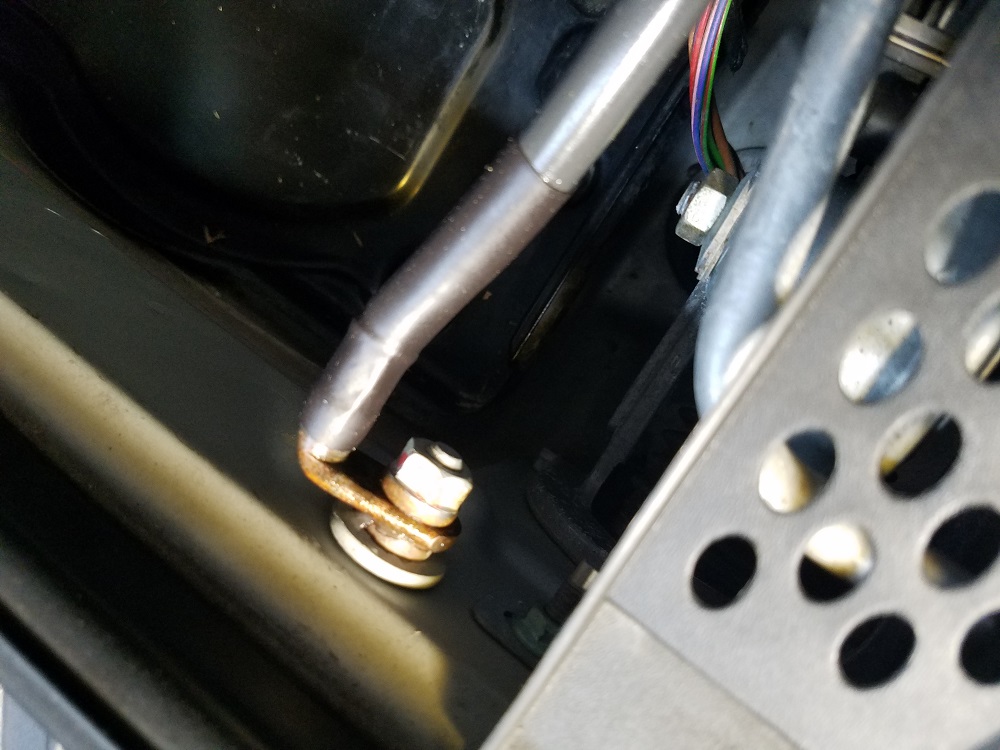

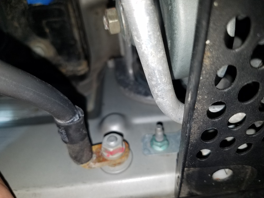

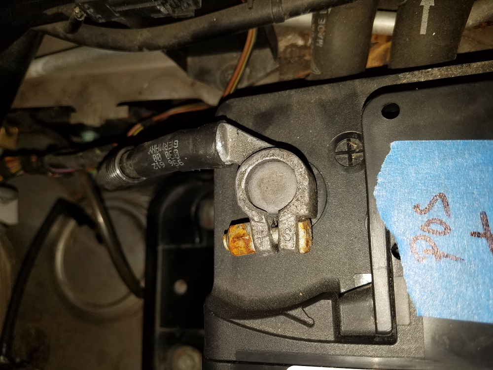

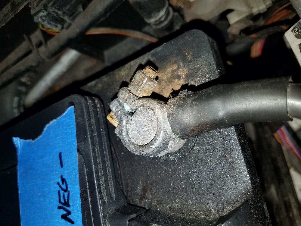

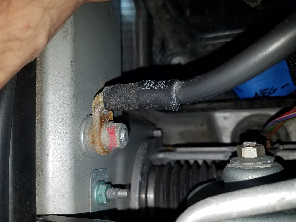

4 Attachment(s)
You guys are great....certainly all above my skill level but I am trying to make you proud. The multi meter is my weakest skill.....its all I can do to set it on volts...select 20.....red on pos...black on neg....and take a reading. When somebody tells me to ohm out something I immediately want to take a nap....does not compute.
Soooooooooooo I know i said I was gunna perform all tests......and was gunna make you proud but this is what i did tonight.
I finally found a fricking mini light bulb that would work for my tail light side marker....that was 3 days of my life i will never get back. I believe it was a Attachment 21967
Attachment 21968
Attachment 21969
Attachment 21970 2528....so glad to see that sucker all lit up. I am now a 986 taillight expert...I can get those fixtures out of there with pit crew speed.
Then I went to work on my 3rd brake light....the previous owner had really worked this thing over. It was loose....not mounted because the body grommets were missing ...most of the brittle plastic clips were broken and two bulbs were out. I got it out...replaced the bulbs and have it back in better then before but wont be happy until it is bone stock perfect......so off to ebay or the for sale section here for a 3rd brake light and some body grommets. At least it works and will get me through local inspection which I need to do very soon.
Lastly I attacked the battery.....I took a quick reading and it was 12.3 ....I decided to remove it completely so I could clean contacts and grounds. The battery is fairly new....April of 2017....but you never know what shock or drain a battery has had. I figure I will take it to Batteries Plus and have them hook it up to their load machine.....and see what CCA it produces...etc Either way I like to start my used cars off with new batteries so I have a good base line. Now if I hook up a new battery and it drains to 12.3.....thats how a dummy like me knows there is an issue! As mentioned before the negative battery cable where it attaches to a body frame stud looks rusted....I also notice the shrink tubing is loose so moisture or salt air could have corroded wires under it. I will thoroughly clean this connection and inspect the condition of the wires then install new shrink tubing and some dielectric grease just to make u guys proud.
Pics tell the story better then I do....so enjoy the pics....batt terminals not bad.....but neg batt stud....not good.

Yup cleaning up that ground connection will be a good thing.
Good thinking on the battery load test idea. Best way to see if it is good or bad.
