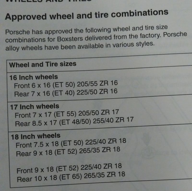

Hi Bentley, Welcome!. Spotted this maybe it might help.
