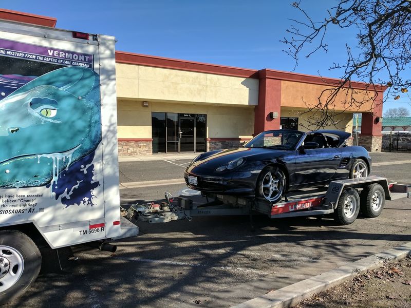

Thank you AOS...
I guess that squealing noise was the vacuum air sound? Very surprising!
I fumigated half of Merced...
