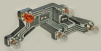

Try looking at the tail light bulb holder, sometimes the metal that secures the bulbs can pop up and not ground a bulb properly. I had to put some electrical tape on mine to stop my brake light from flickering.
Here's a picture of the metal I am talking about:
