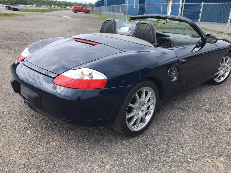

My S had a pair of the Depo rear lights fitted when I got it and although they worked fine the fit wasn’t that great to be honest, I.e compared to the oem ones they didn’t run flush to the body work and there was a bit of a lip/ step up. Look at my photo below at the left hand Depo light vs oem at the top you can see the lip clearly. Still good lights but glad I have gone back to oem albeit slightly modified ones to give me the red rear light modern look.

I agree. Neither the Depo or Dectane lights fit well and they look a bit cheap.

I wasn’t too happy with the fit either until I noticed that the foam gasket supplied with the Depo lights was thinner than the OEM. After swapping the gaskets and reinstalling the lights the fit was much better.
