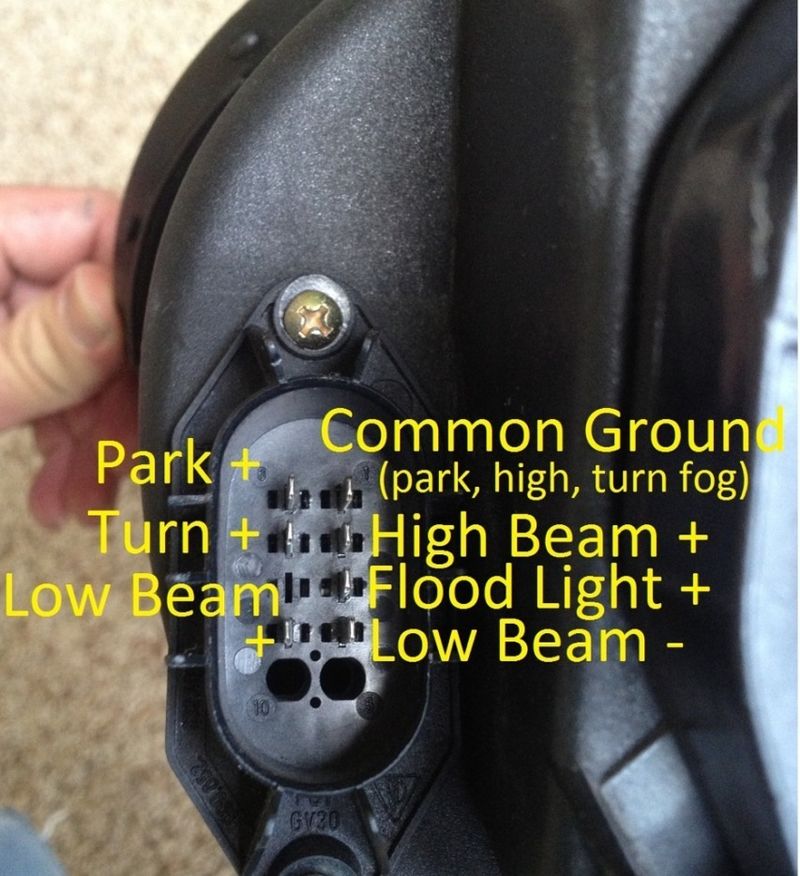

I put the stock lights back in, no issues so i know it is from the new Lightronic headlight. I took off the back cover and the wire coverings literally disintegrated falling off in a million pieces leaving plenty of exposed wire. So i got some of the liquid wire covering and set off at trying to coat the wires, it was tedious and i did the best i could, however after plugging back in the fuses still blow immediately.

You obviously have a short somewhere. Remove the high beam and parking light bulbs, then test the connector to see if you have a short.
Using a multimeter on continuity check, place one lead on the common ground pin and the other on the high beam positive pin. Should read no continuity. Repeat with the common ground pin and parking light pin.
