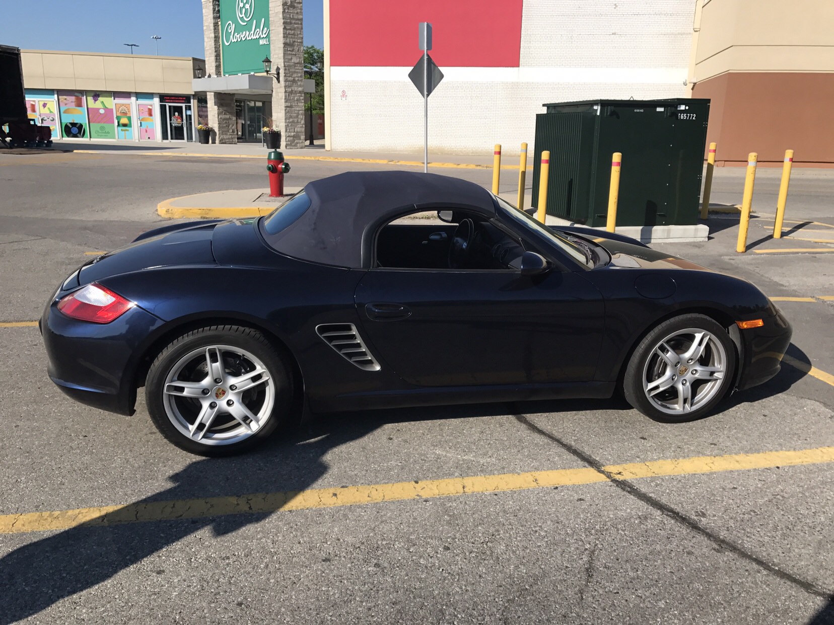

Gentlemen, thank you again for your suggestions but I ended up with the 987. I drove both of the vehicles again and the condition of the 987 wasn't actually worse than the 986; this was my misjudgment. So, newer car, slightly more kms with in better overall condition and more complete maintenance records made me choose the 987.
Thanks again for your recommendations! I hope not to be thrown out of the forums! Cheers.
