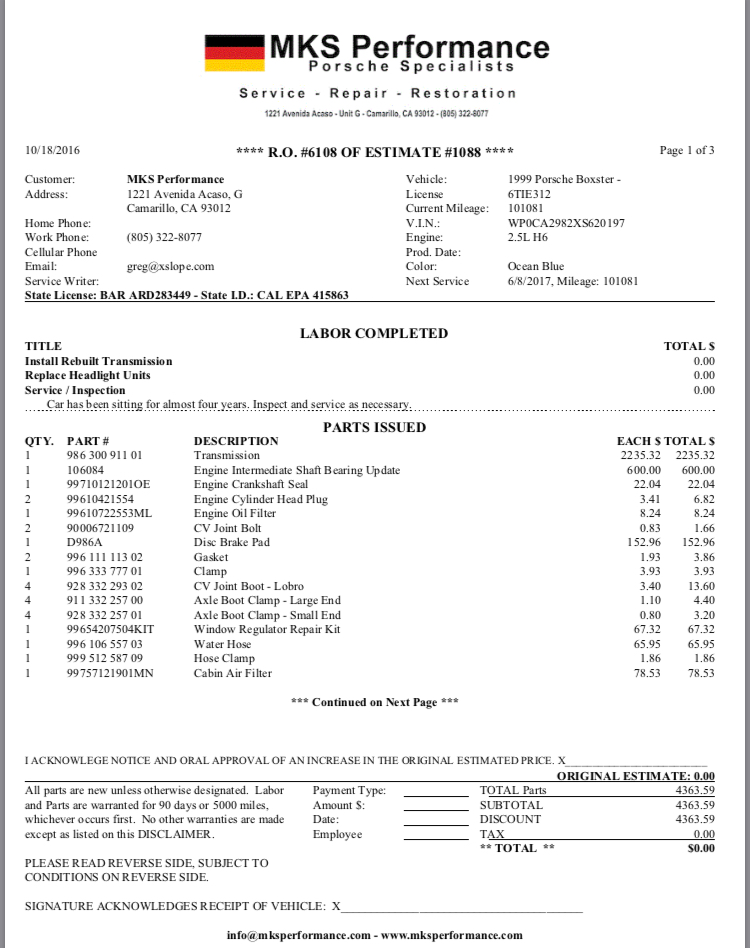

Hello everyone,
I'm trying to find the IMS/RMS on this invoice on a 2002 Boxster S. I was told by the seller that it was done at the same time as the clutch. Well, the invoice for the clutch is attached but I don't see the IMS/RMS as a line item. Can you help me out?
Thanks!

Originally Posted by mltranmer (Post 570619)
Hello everyone,
Thanks!
997-101-212-01 looks to be the RMS.
996-105-024-01 comes up as the IMS flange. From the looks of the part on the Pelican website, it appears to be a flange associated with a single-row bearing.
I don't see anything that indicates that they replaced the IMS bearing though...

mltranmer 05-17-2018 06:00 PM
Thank you! Maybe they inspected the IMS and it looked good?
NewArt 05-17-2018 06:21 PM
It’s not done. Probably wasn’t necessary. They don’t all break. When I had mine done at around 60k miles, my mechanic said that the old one was in great shape. Maybe I blew a couple of grand for nothing? Toss the dice.
JFP in PA 05-17-2018 06:23 PM
No, they just resealed it.
thstone 05-17-2018 09:40 PM
RMS yes.
IMSB no.

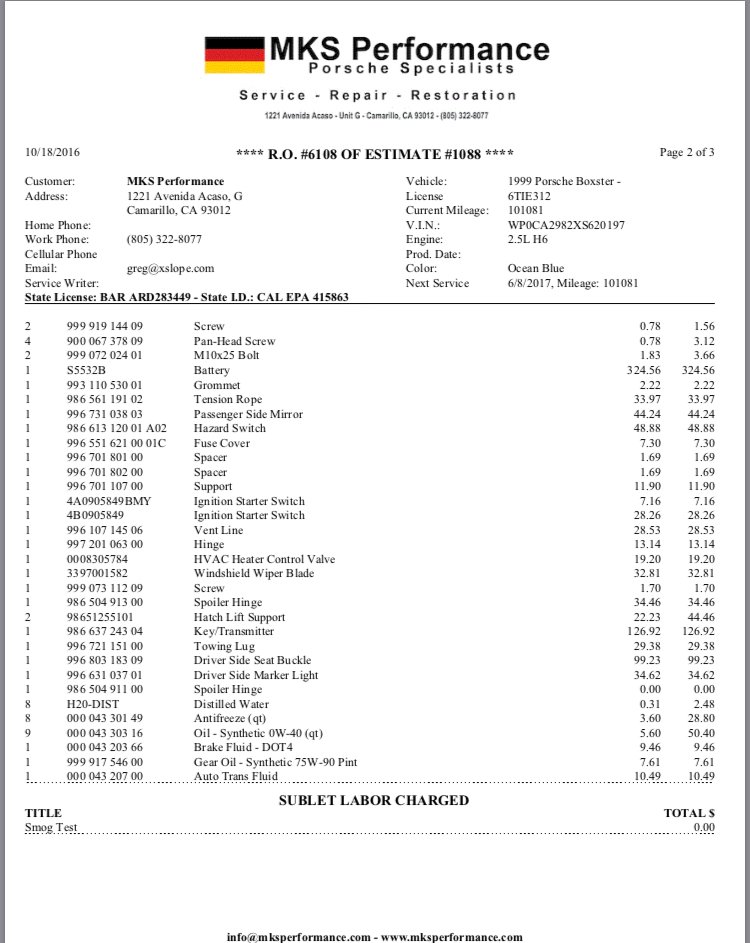

ndfrigi 05-19-2018 02:45 PM
2 Attachment(s)
here is a receipt of mine and this does not include labor yet. You will see the details of the LNE IMS.
Attachment 21490
Attachment 21491
