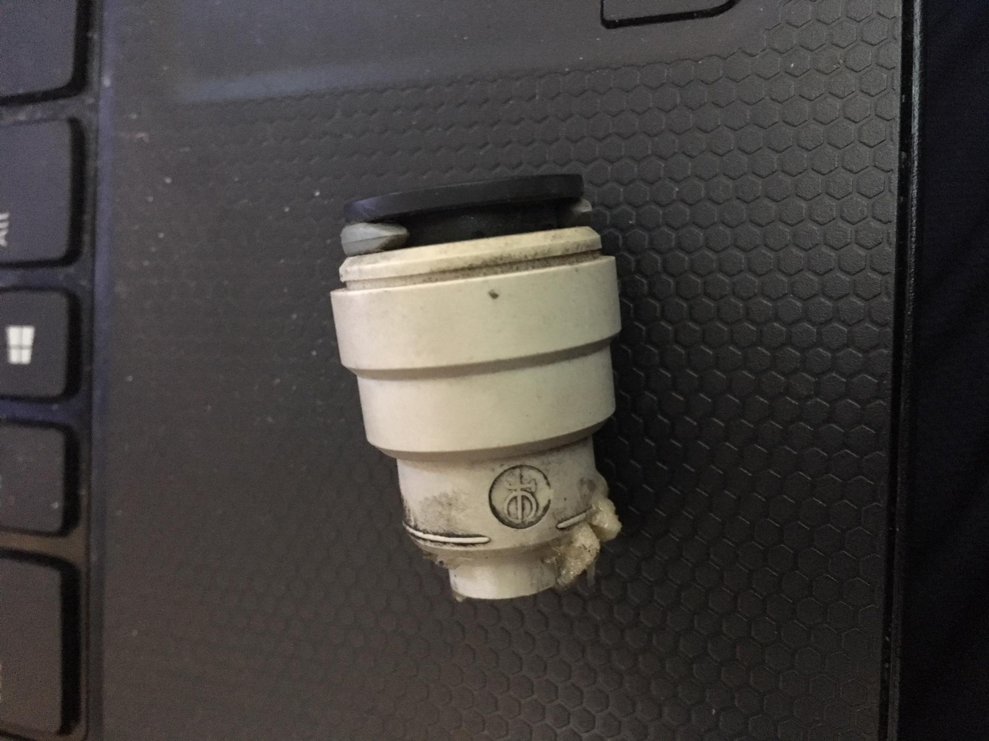

Hello,
I have a vacuum leak on my 2001 Boxster and when I touched the brake booster connector on the passenger side intake manifold, it broke right off so I'm assuming this is the cause of my leak. Do they sell just the quick disconnect connector in the photo? If so, please send the part number.

As far as I could find, only the entire assembly is available (not just the connector).
The PN of the venturi tube assembly is 996-110-170-00.
Intake Manifold Venturi Tube 99611017000 - Genuine Porsche - 996-110-170-00 | Pelican Parts

the problem you may run into by using a used rubber/plastic component is that plastic hardens as it ages and you may end in the same place sooner than later...
IMHO, on these type of components is better to buy a new part, at least is a little over $100.
Wait until you need the plastic tube (that includes) the vapor recirculating valve that connects the throttle body with the carbon canister...

BRY - mine is also broken. Did you ever find a source for just the fitting? Mine is a John Guest 15mm push-in adapter.
