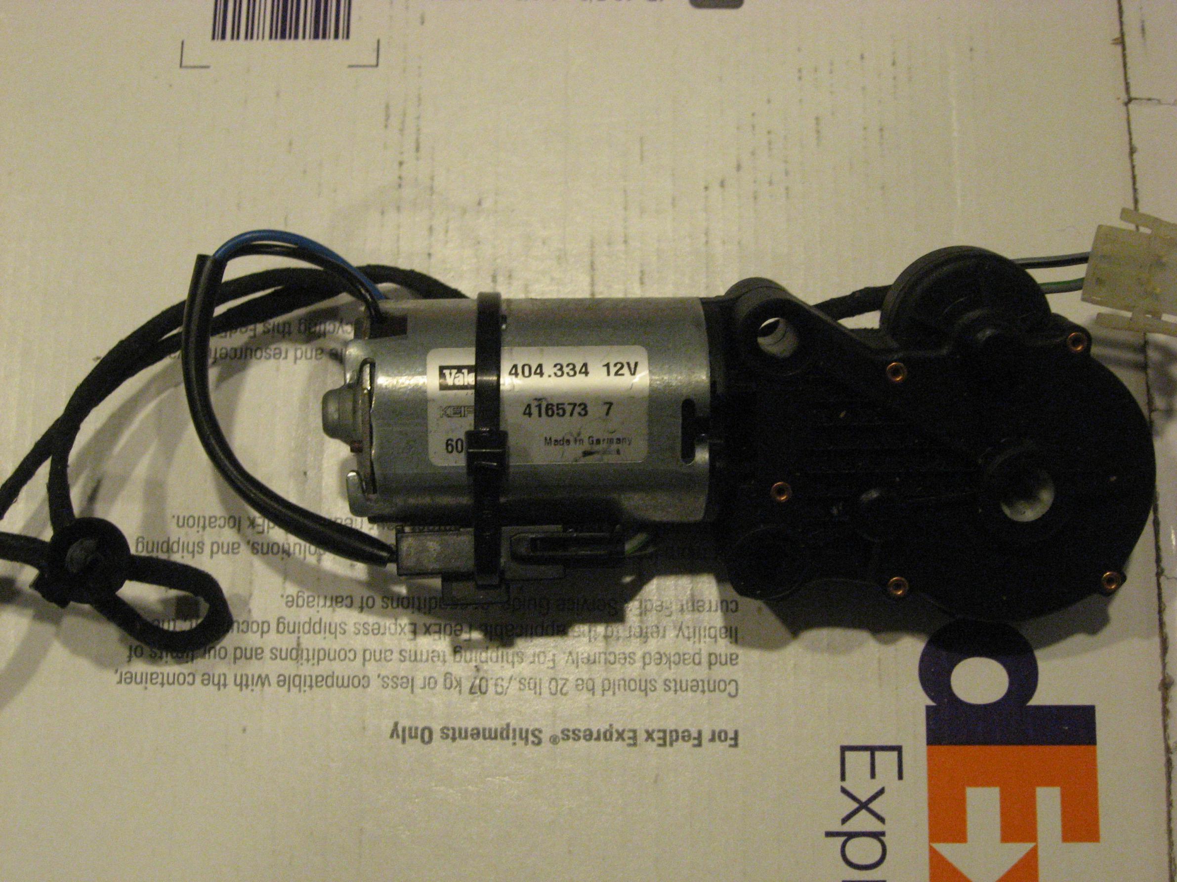

Here's a picture of the seat recline motor
I think the motor is the same for both seats, but you can check the part number on the label and confirm that.
