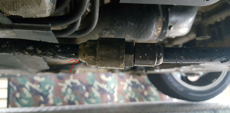

Here is a diagram of the power steering system; the couplers are #15 and #16.
This is what the coupling between the front and rear power steering lines looks like; I had a leak at the red arrow.
