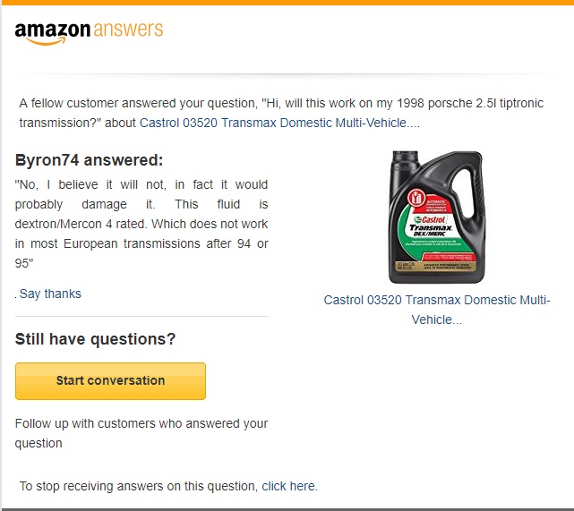

hello
i asked the amazon community a question regarding it's suitability for 986 porsche, this is the response..
can someone help!
much appreciated :dance:

The fluid our tip required is Mobil ATF #3390
Your Porsche Service Center is a far more appropriate venue for questions about engineering and their compatible fluids. All it takes is a VIN# and 5min phone call mate (its free)

You want this:
https://www.mobil.com/english-us/passenger-vehicle-lube/pds/glxxmobil-atf-3309
If you categorically refuse to source it from the P front desk, for some strange reason, here goes the SG Mobil 1 distributor list for you.
Find your preferred Mobil 1 Car Care outlet | Mobil 1 Singapore
In this article you'll find the genuine porsche part no ( 999-917-545-00) if you need, along with other ATF alternatives. No exp with the later tough.
Pelican Technical Article: Changing Boxster Automatic Transmission Fluid - 986 / 987
Hope this help. Long life to the Tiptronics

Pentosin 1058206 ATF-1 Synthetic AutomotiveTransmission Fluid, 5 Liter
https://www.amazon.com/gp/product/B00JMAQ0LW/ref=oh_aui_detailpage_o00_s00?ie=UTF8&psc=1
This is the stuff that came in your Tiptronic from the factory - same as Porsche P/N: 999.917.547.00
5 liters is more than enough to refill it after a filter change, but you'll need more if you want to change what's in the converter.
Amazon is showing me a price of $70.53 USD (Amazon Prime price with free 2-day shipping).
I have no idea what the shipping would be to Singapore though...
Hope this helps.
