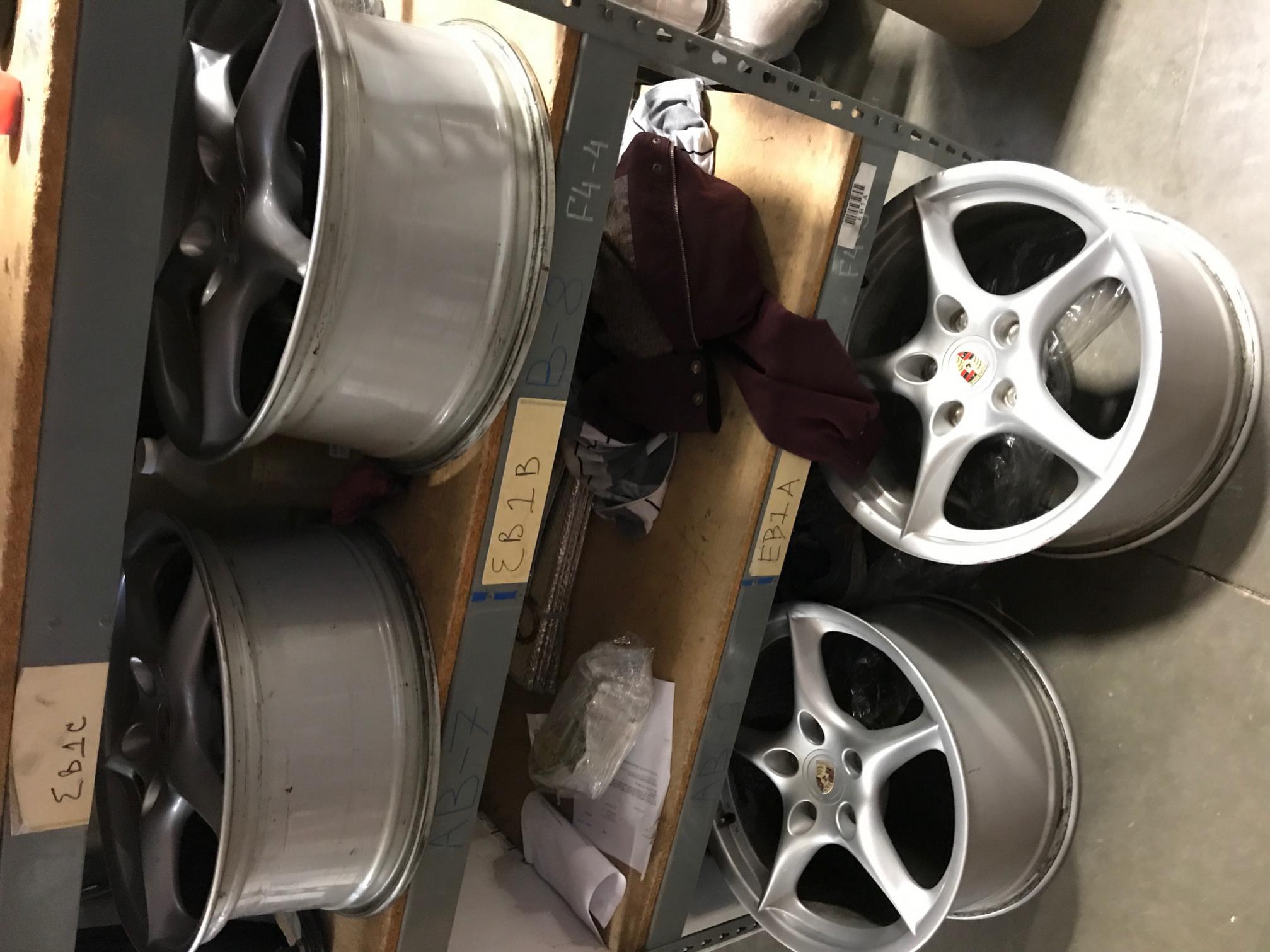

Well I purchased a nice set from EBay. Straight and true, no cracks, minor curb rash w/color center caps for $1,000 including shipping! I thought it was a pretty good deal for what there going for now. Attached picture
