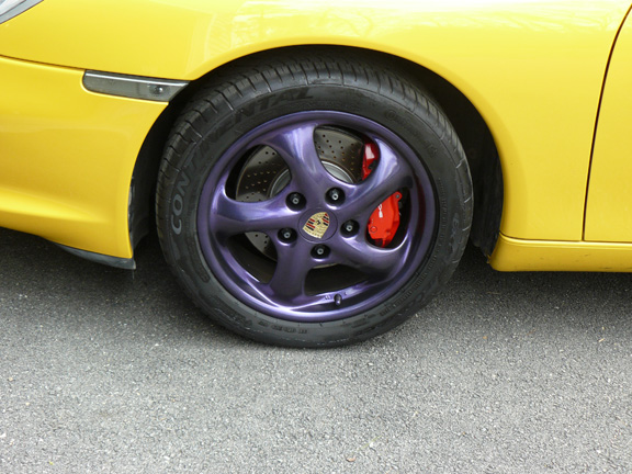

Plastidip Meets Wheels
Neeed a change so.....

Neat!
Gives a different look, for sure.
Try the mirrors and windshield frame too.
But seriously, is that stuff difficult to work with?
I've been on the fence about doing the wheels on my Arctic Silver car a darker Anthracite colour to mimic the 550SE wheels.

The stuff is great...peels right off. Try dipyourcar they have kits....videos...etc

Black wheels goes well with the yellow. Nice job.
Oops! Didn't look close enough. Thought it was black. Lol. Interesting.
Old 04-30-2017, 11:46 AM   #6
I personally think black would have looked better with yellow, but it looks good.
What color is that?

DYC calls it Violet. The wheels are dark anthracite under the dip

Looks nice. How many coats per wheel? And how many cans did you use for the set?

Plastidip is very user friendly in that it's hard to get runs and dries very quickly. The only caution is to spray many coats like 5/6 to ensure a easy peeling in case you get tired of the color. Thin coats tend to make peeling a real pain. They other minus to Plastidipping is the wheels tend to get dirty quicker from brake dust and debri cause it leaves a rough surface. That said DYC sells a after spray to reduce road/brake dust. It's a great way to see the actual color on a wheel. The wheels look great by the way!

This color was a kit from DYC. 3-4 heavy coats of black base. Metalizer Violet 2-3 coats depending on how Violet you want them and then at least 1 heavy coat of glossifyer (clear). The wheel cleaner works great. Also, the kit comes with a product you put on the sidewall that prevents the plastidip from sticking to the tire so the overspray just peels off.
