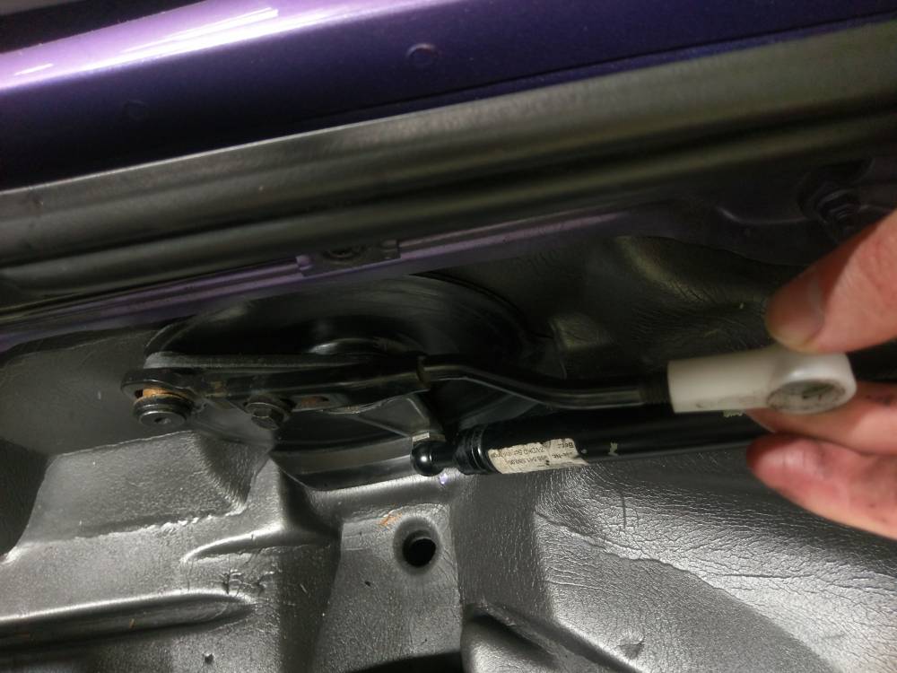

I am installing a used top, mine did not function when I bought mine. I have had to replace one of the hinges which was cracked. Was about to install the new top when I noticed the plastic or rubber in the arm had worn away causing play.
Any idea what these are called and is there somewhere inexpensive to get them? Name:  IMAG1350.jpg

I'd suggest to just get those from Porsche dealer; they only cost a few dollars.
"Cabrio Rubber Buffer"
Part number: 986-561-881-00

You are missing a rubber cushion that the bolts the motor crank through the link. the cushion goes into the hole on the link then a brass collared hat sleeve then a steel collar then a 8MM flat head socket screw.
Part# 98656188100 Rubber bushing
Part# 98656257101 left hinge arm
Part# 98656157201 Right hinge arm

Many thanks guys. I will order from Porsche Monday
