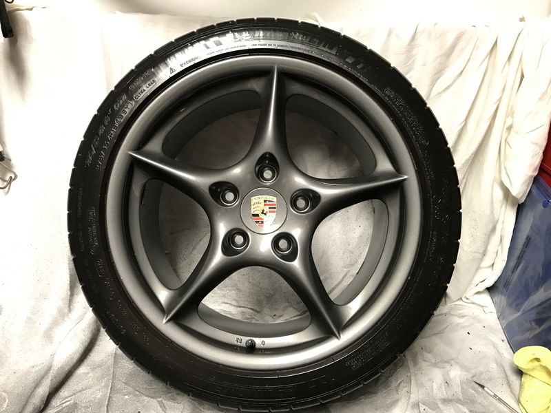

After almost 4 years of having Plasti-Dip on my wheels it was time for a refurbish of my wheels. Up went my car on jack stands and off came my wheels. After trying to peel it off I knew there had to be a better way, so I soaked the wheels in WD-40 overnight and the next day sprayed on some Goo Gone. The next thing was to pressure wash the wheels with a 2700 psi pressure washer. This is a durable finish but no match for 2700 psi. Next I sprayed on some de-greaser and used a brush to get rid of the grime on the inside of the wheels. As long as the wheels were off I figured that some good insurance would be to have them all balanced (I also may have pressure washed a weight or two off.)
After prepping the wheels with rubbing alcohol I sprayed on 3 coats of Anthracite Grey and let that dry. Next was 3 coats of Glossifier. I watched a YouTube video by Fonzie at Dipyourcar.com to get it better this time and, I must say, his "wet coat" technique makes the wheels come out perfect and shiny. Looking at them you would never know that it was $70 worth of rubber coating on them.

Damn, Looks like a factory finish! Good job

One thing to note, you have to get them balanced before you coat the barrals as I would not think that weights would be very secure on Plasti-dip.
I ended up removing the coating on the barrel as I it became PITA to recoat them every time I change tires or get the flipped on the wheels

I had them balanced before I coated them because I figured if the shop had a chance to F@#$ up the finish, they would.

That looks great! Nice job.

Also, if you do many (at least 5) coats it is more likely to peel off. Also there is a Dip remover...just spray on and hose off.

That looks like the factory 550SE wheels. Nice job!
