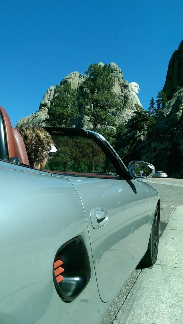

P.S. We had many nice drives in the Black Hills this summer. Even got talked into entering a car show!

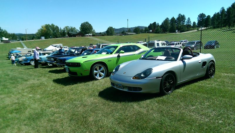

At the car show in Custer, SD - summer 2016 Things I like about this car, German quality, affordable, styling (about 100x nicer to look at than a Z3 and 500x nicer than Miata in my opinion)
