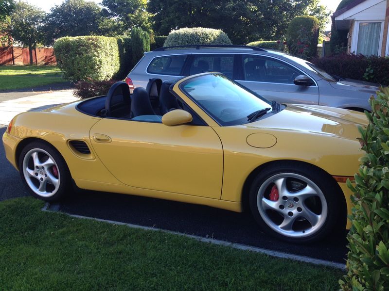

Hi Guys
In a recent review M030 suspension was mentioned as being a more desirable set up.
Just wondering if my car will have it already, its a 2000 UK S.
Seemingly they make the car sit a bit lower, Cant see how mine could sit any lower on its 18" wheels
Visually its one of the things I like on a car, when the wheels fits the arch more or less equally all the way round.

If your car came from the factory with M030, there should be an '030' option code on the underhood label.
I have the factory M030 USA. I believe the M030 ROW is a tad bit lower.
