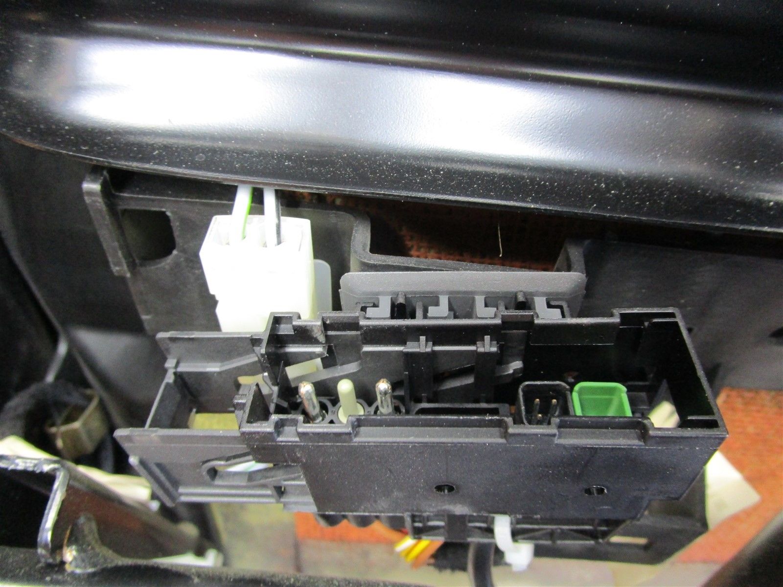

Here are some pics of the bottom of the seats and the connectors.
Think I look good for plug and play with my 2-way power seats? I don't see any big black box for a memory module.

They are definitely not memory seats. They look like they will be plug and play for the power seat back. I think I can also see the components for the seat heaters.
I would go ahead with the purchase if the seating surfaces are in good condition and the price is right.
Good luck with the purchase.
