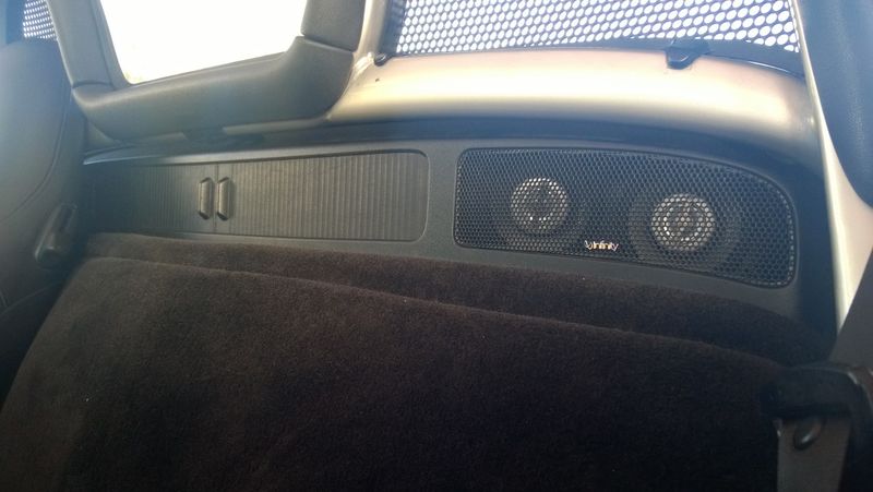

Posts: 63
I added the speaker kit for the rear (used Infinity Ref)and a 6 channel 996 amp. I can hear it with the top down at 75mph. I think it turned out great.

Nice install!
