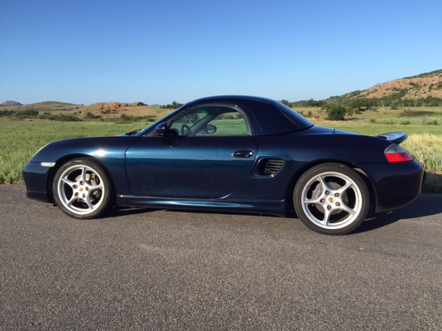

Old 12-19-2015, 08:22 PM   #3
RedTele58's Avatar
Here are the two different tops. The silver car is an earlier top with ears (1997-1998). The blue car is a later top (1999-2004) with no ears. Either early or late top will mount on either early or late 986. In fact, the silver top (from a 1997) is mounted on a 2002 S. The blue car is a 1999.
