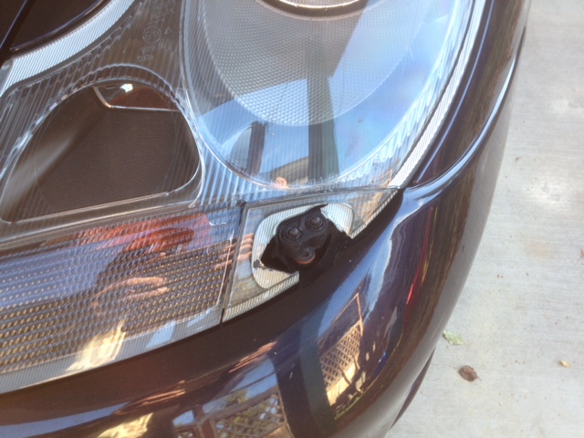

Got clipped in a parking lot yesterday
Can someone let me know if the small damaged section can be replaced alone, or does the whole headlight assembly need to be replaced?

Pretty sure the corner piece is separate but make 'em pay for a whole headlight

The corner lens is a separate piece.

Thanks! Is this something a body shop should do, or is it pretty straightforward to replace?
Old 09-25-2015, 10:10 AM   #5
It just snaps on. Takes about 30 seconds to slide the headlight out and replace.

I found this youtube showing the removal of the whole headlight assembly, which is pretty cool!
https://www.youtube.com/watch?v=D65x8G1f6AI
But I am still unclear about how to replace the corner section. Once the assembly is out, does that piece just unclip?
Old 09-25-2015, 10:44 AM   #7
Yes, it just has 3 small clips.

That looks to be the corner unit that has a hole for the headlight washer. Same process but different part.

This one, right?
2001 Porsche Boxster Base Convertible - Exterior Trim - Page 1
The youtube I found earlier might have mentioned this, but I have no audio at work.. What size ratchet is used to loosen the headlight assembly?

5mm i think.

That is the correct part.

there should be a special tool that is the correct size in your spare tire tool kit to remove the headlights, it is 5mm i believe
