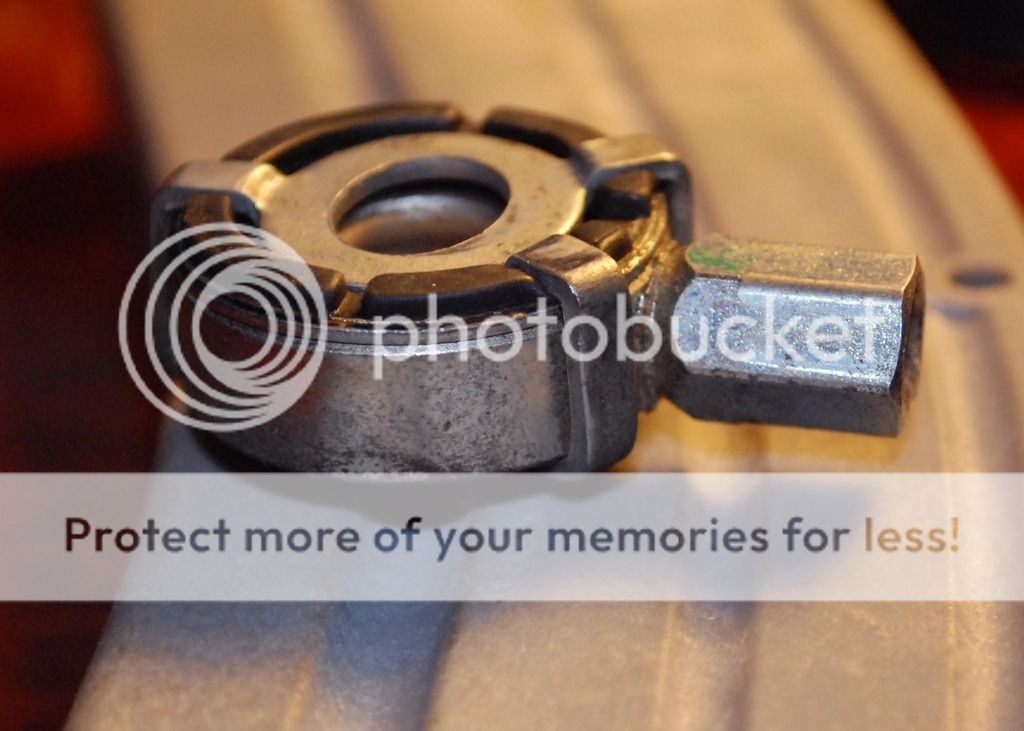

I found it
Pretty sure this is it....any fix except a new cable ?
Looks like you could drill a hole in it and put a pin through it ???
Old 09-01-2015, 04:39 PM   #12
I am my own mechanic....
Timco's Avatar
Location: Salt Lake City, UT
Posts: 3,432
As a temp fix, yes. That's your issue. Maybe JB weld as well. You'll be replacing that anyway.

The cable is broken. Count your blessings and replace it with a new one.

Those are up for auction and still have 4 days left. Have you checked with Woody? There isn't a ton of pressure on that cable. I like the JB weld + vise grip crimp. That's what I would do if it were my car.
They are only crimped to begin with, so your fix may end up being better than original.
OR...
Better yet, an appropriately sized set screw shaft collar. Drill a hole through one side of the crimp connector for the set screw to pass through, install collar, tighten set screw down to clamp onto cable end.
Old 09-02-2015, 09:32 AM   #19
Location: Georgia
Posts: 391
In looking back at your picture you could fix that cable I guess as it didn't break, just came apart... I would still recommend replacing them, but...
You could drill a hold in the cable end and tap a thread into it and use a screw to pinch the cable into place, like a "cable stay". Or you could crimp it with a small vise too...
