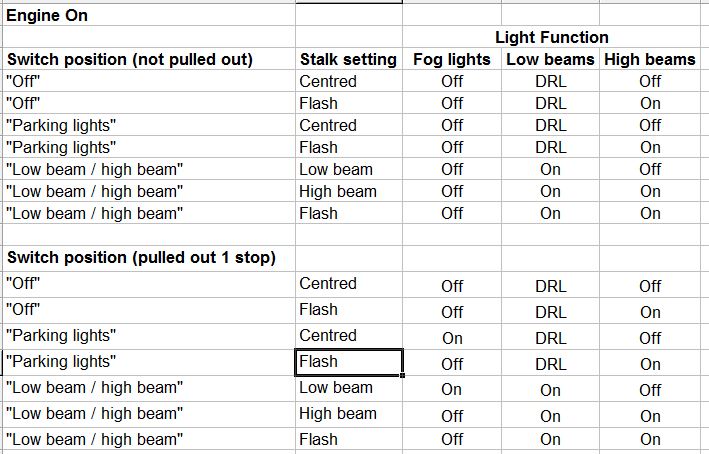

When the turn signal lever-switch is pulled back toward the driver, the head lights flas. My question is: Which bulbs participate in the flash ? High beam bulbs or low beam bulbs ?

In Canada, the lows are on all the time as DRLs. Flicking the switch to flash setting adds the high beams.
Sorry I can't tell you for sure what it is in the US, although I imagine it's only the highs.

High beams.
