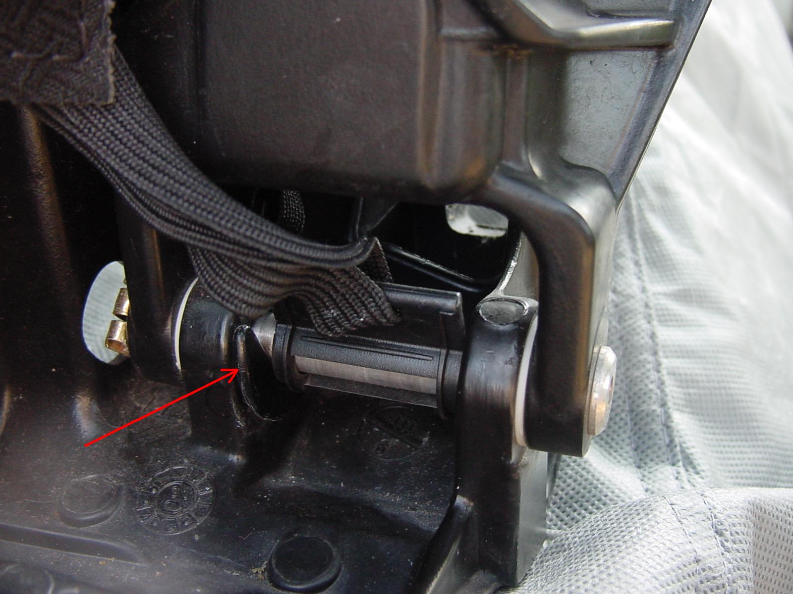

Does anyone know where this convertible top strap should attach?
It flops around and makes a lot of noise when the windows are down. I can't see where it attaches on the other side so before I start taking things off I thought I woyld see if anyone has a hot tip for me.

Found it!
Conv Roof Interior elastic band with hook - 986 Series (Boxster, Boxster S) - RennTech.org Community

The article says if you put the top in service position and then look from the back of the car down to the B-pillar there is a horizontal small bar that should have another clip/strap like this attached, and this one in my picture should clip inboard of that one.

Here is the main image from that site.
