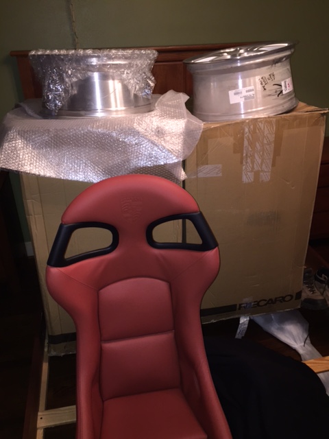

I just happen to have two refinished Sport Design wheels sitting in my spare bedroom. (When you're a bachelor you can get away with such things.) The 9" wheel was 26.4 pounds. 8" wheel 25.4 pounds.
Both wheels are stamped BBS w/ Porsche part numbers.

Based on your choice in seats I can see clearly that you are a man of superb taste.
But six pounds of extra rolling weight is going to take a little oomph out of your red light take offs. Which of course calls for UD pulley, lighter aftermarket exhaust and headers, console delete, Optima, etc.
