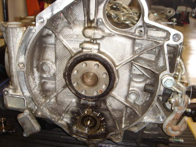

Anyway, started and drives great- no more smoke, seems more lively. 5-6 miles later CEL P0341 (CPS I believe). Read several posts about possible shorts being the culprit.
Questions? If it's shorting, would it run so well? Possible I pinched or damaged a wire doing the AOS? Where is the plug in for the CPS?

The CPS is just below the AOS. On the right side of the case, the big black sensor @ 3:00 position with the wire coming off to the right.

Thanks, great picture
Thanks for the good picture- I guees I need to see if I goofedup the wire or pinchec it.
