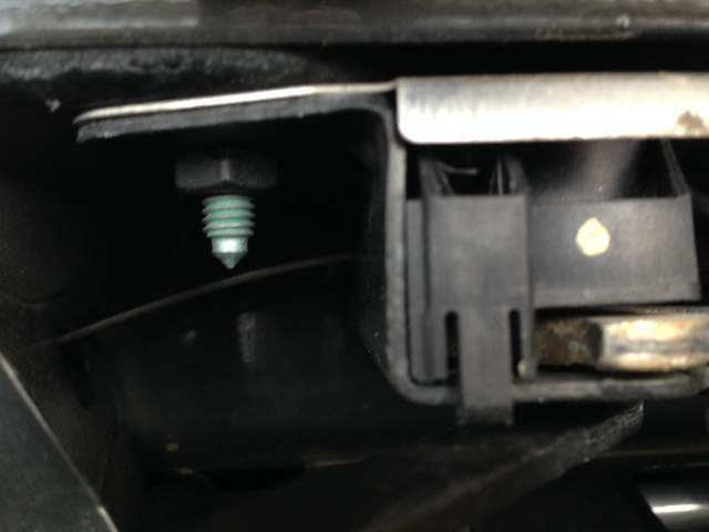

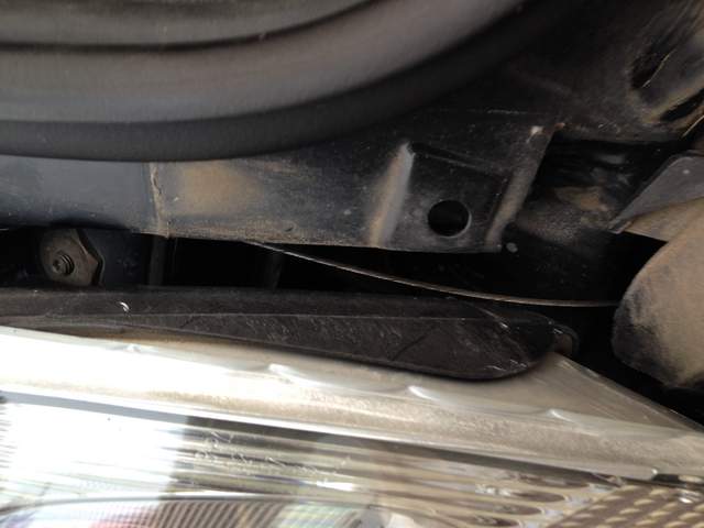

I removed the plastic trim in the frunk where the latch is, and as I was going to remove the headlight, I saw the cable, managed to fish it out and relocate it to the tow hole.

Nice! So you found another way to get the cable without having to remove the headlight or the pazsenger tire. Good work. Is it easier to fish the cable to tbe tow hook cover from the latch?
I still routed it down behind the bumper to the tow hook and made sure it has an unobstructed route
