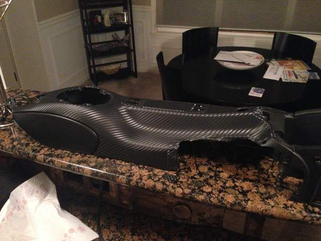

Well I spent tonight working on this. Results were....OK. Not great but OK. I have to say much more difficult than expected on the first try. I think doing it again would be a lot easier. Good news is the wife approves...so getting put back in the car this weekend.

Well...aside from the obvious of watching a bunch of youtube videos....I can only offer A) it's a two man job....one does the application and the other holds the heat-gun/hair-dryer B)buy the primer....it helps and C)go center-out and don't cut anything until you're done with the stretching part.
Good luck!!! It looks really nice when you're done and the stuff is pretty darn tough.

What kind of wrap did you use? Di-Noc?

I am guessing 3m 1080....3m Dinoc is quite a bit harder to work
with than the 3m 1080 films.

Yes - DiNoc...not 1080. It's pretty cool stuff. Next will be the little door flappy lids.
Here's everything put back together. (Icing is I bought an extra Porsche button and wired it to a garage door opener. BLISS. Little things in life....)

what hydro dipping is or that it exists...FYI...if you purchase more material to do the doo r pockets, the 1080 is easier to work with and much more flexible than the DINOC.
